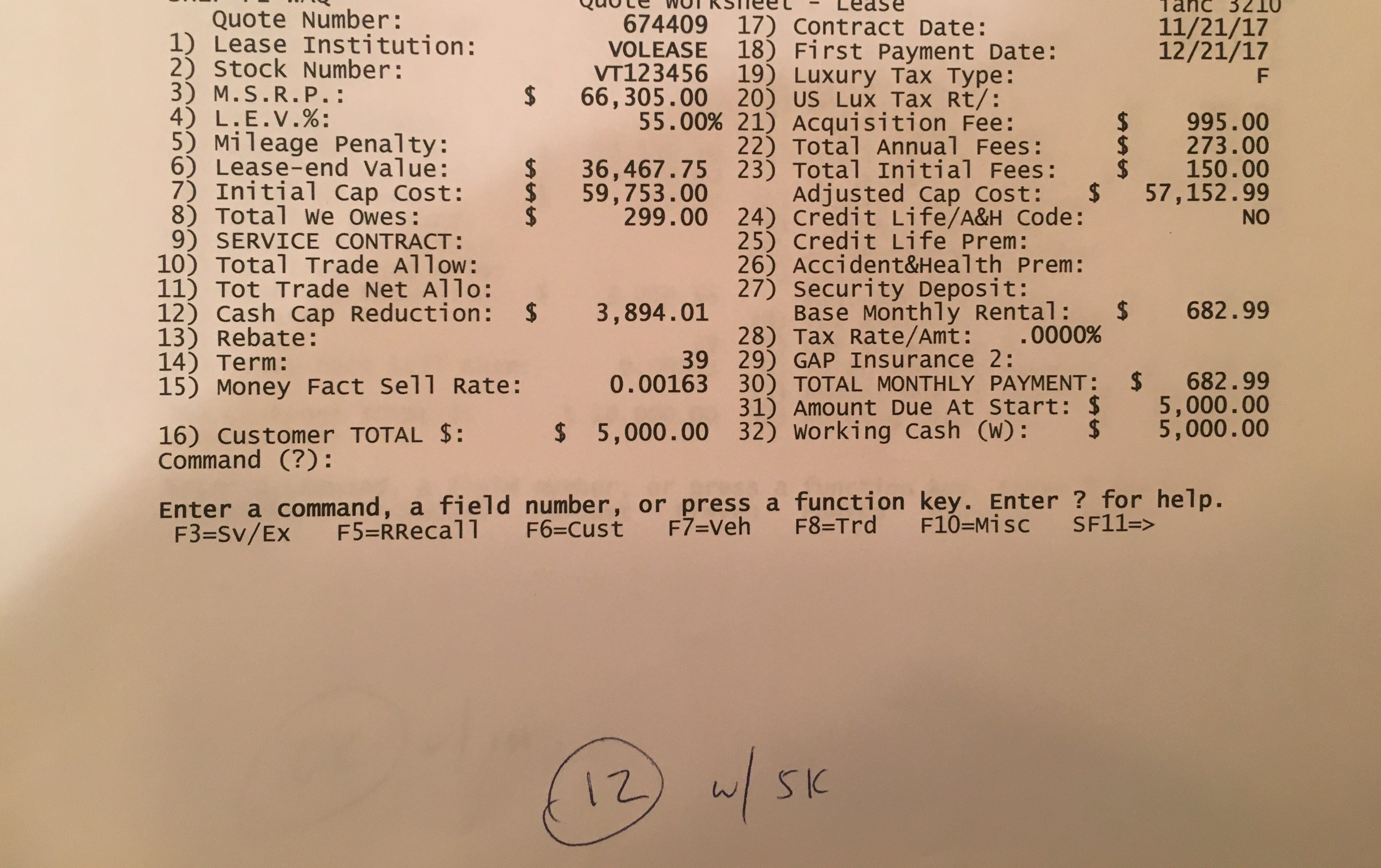

  • bigb316bigb316 Member Posts: 11
    Help
    Need Residual and MF for 2018 XC90 INSP WITH CON PACKAGE AND 21' TIRES in Texas
    Quoting me 922.05 A MONTH FOR 39 MONTHS 15K WITH $3750 down.
    Sales Price is $63305
    Fees and Doc is $640
    Tax is 6.25% on sales price
    They are saying MF is .00159 but rebated to .00149
    Seems high.
    Please help

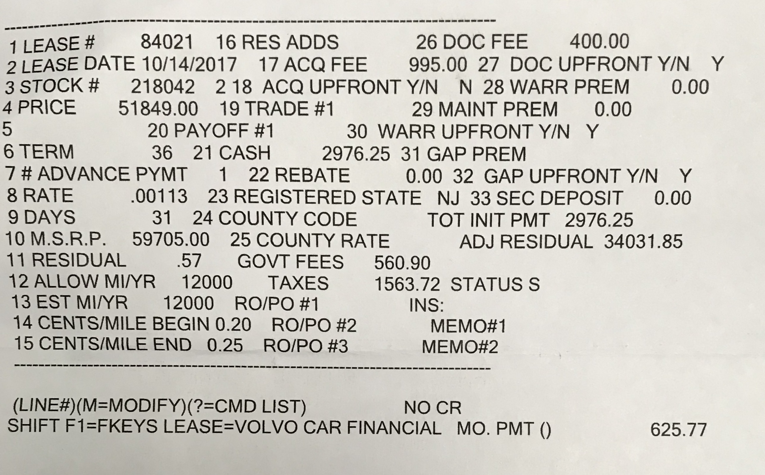

    T6 momentum Dealer price $51500
    12k
    What would be a good lease offer for 36 or 39 months
    Missouri
    Thanks you
  • kyfdxkyfdx Moderator Posts: 267,789
    bigb316 said:
    Help
    Seems high.
    Please help
    T6 Inscription?
    .00084 MF and 49% residual
    $3000 Volvo Allowance
    What is the MSRP?
    Adjusted CAP cost?

  • amms1001amms1001 Member Posts: 11
    Need help please
    12k
    What would be a good lease offer MF and residual for 36 or 39 months
    Missouri
    Thanks you so much

  • MichaellMichaell Moderator Posts: 265,000
    amms1001 said:
    Need help please
    12k
    Missouri
    Thanks you so much
    What's the MSRP?
    Exactly - need both the selling price and the MSRP to calculate a payment.
    .00113 and 57% / 55%; $3000 Volvo allowance

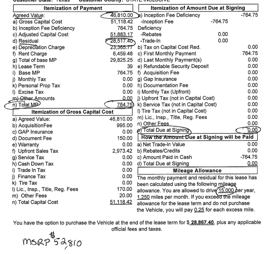

  • farawayfaraway Member Posts: 6
    I got a lease quote from a dealer in TX.
    MSRP: $59,190
    Initial Cap Cost: $53,045
    RV: 57% / $33,738.30
    Adjusted Cap Cost: $57,535.38
    Term: 36/12K miles
    MF: 0.00113%
    Tax: $3,323.38 (6.25% sales tax)
    Monthly Payment: $764.17
    Could you please let me know if the monthly payment is correct?
    MSRP: $59,190
    Term: 36/12K miles
    MF: 0.00113%
    Just wanted to add that the monthly payment of $764.17 consists of base payment of $653.25 and $110.92 for sales tax/fees.
    MSRP: $59,190
    Term: 36/12K miles
    MF: 0.00113%
    I get the exact same payment
    Also, confirm .00113 MF and 57% residual for T6 Momentum
    Need help please
    12k
    Missouri
    Thanks you so much
    What's the M help please
    MSRP $58900
    amms1001 said:
    amms1001 said:
    Need help please
    12k
    Missouri
    Thanks you so much
    MSRP $58900
    With the prices provided, I get $594/mo (36) or $585/mo (39)

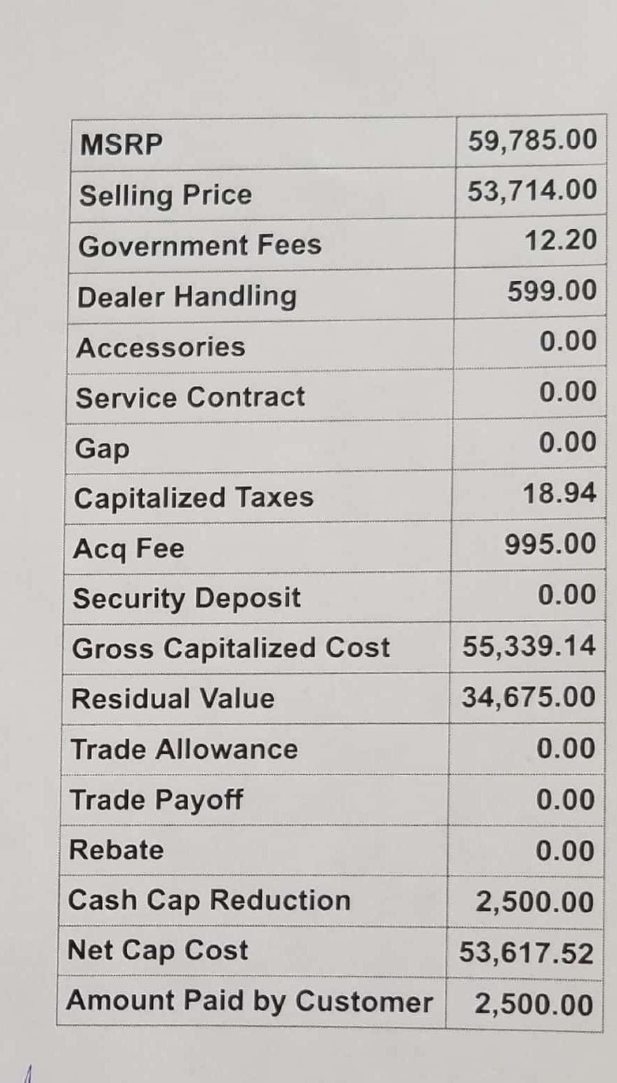

  • bluestreakingbluestreaking Member Posts: 11
    How is this deal?
    2018 XC90 T6 Momentum AWD
    36 month, 12k miles, $2500 due at signing
    MSRP $60,800
    Selling price $53,656
    Payment including all fees and taxes $638 per month
    The Money Factor is .1130
    The Residual is $34,656
    Dealer Admin Fee is $599
    Bank fee $200
    edited October 2017
    More details:
    MSRP - $60,800
    Selling Price - $53,656
    Monthly Government Fees - State Tax $17.79 Per Month + RTD Tax $6.75 Per Month

    How is this deal?
    MSRP $60,800
    Bank fee $200
    More details:
    MSRP - $60,800
    Dealer Handling - $599
    Capitalized Taxes - Cap Reduction Tax $71.14 Come out of down payment.
    Acquisition Fee - $695
    Gross Capitalized Cost - $54,950
    Residual Value - $34,656
    Cash Cap Reduction - $1,778.53
    Net Cap Cost - $53,171.45
    Amount Paid by Customer - $2,500
    Payment - $638.11
    Money Factor .1130 - $99.25 Per Month & $12.20 State Filing Fee comes out of Down Payment
    (36 month, 12k miles, $2500 due at signing) - $638.11 First Month Payment comes out of Down Payment.
    .00113 and 57%; if your sales tax rate is 4%, I'm only pennies off of that quote.
    We'd suggest you restructure your deal to only come up with the first payment and registration costs at signing, not $2500.
